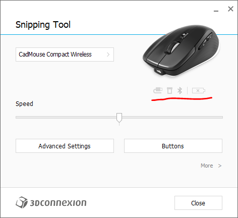

I notice the connection icons under the mouse are all greyed out so looks like its not properly seeing the device. See attached screenshot.

Not sure why image didnt attach in post so uploading here.

Where is the screenshot?
