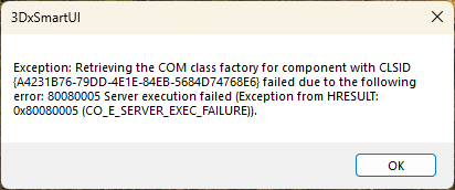

Hi all,
I've had the spacemaouse wireless for a few years and just went to use if on my laptop for the first time.

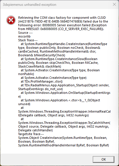

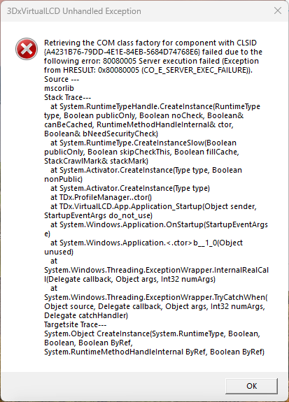

It's windows 11 and I installed version 10.9.12 of the driver software. It works, but throws a bunch of errors.
I tried removing, deleting the associated folders from %appdata% and reinstalling but it does the same thing.
On the first install, I can get to the config app with errors, but after a reboot, all I get is errors....

Download Visual C++ v14 Redistributable
You may want to clean the 3DxWare driver configuration on Windows and you can get in touch with our Technical Support Team. Please visit https://3dconnexion.com/support/.
