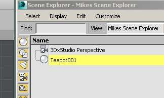

I'm not trying to create a new camera in MAX.
I'm saying that the way the 3Dxstudio SpacePilot driver has always functioned is by creating a special 3Dxstudio camera object in the MAX scene each time you go to move the SpacePilot knob. It has always done this and you can see the new special 3Dxstudio camera object appear in the objects list in MAX each time you touch the knob. As you use the move the knob/stopped moving the knob/move the knob/stopped moving the knob, etc. the special 3Dxstudio object appears in the list/disappear from the list/appear in the list/disappear from the list, etc. This causes the Scene Explorer/Selection Floater/Layers Dialog (or any other object list dialog) to constantly refresh as the knob is used and is super distracting and also slows down the MAX system and viewports dramatically. When these dialogs are closed... the result from using the SpacePilot knob in the viewports is far faster and more fluid. But in my workflow, I need these dialogs open all the time and it's a huge pain to close them just so using the SpacePilot is more fluid.
When I have all three dialogs open (Scene Explorer/Selection Floater/Layers Dialog) and move the knob... the special camera object is constantly displayed/undisplayed again and again in all dialogs which makes my desktop look like Las Vegas. If I use the Hide Cameras function in the Display Tab or Display Floater and move the knob... no cameras are displayed in the Scene Explorer or Selection Floater and these dialogs don't refresh constantly (which is as desired). But the Layer Dialog continues to flash each time the knob is used.
My feeling has always been... create the damn special camera object one time (if it doesn't exist already) and don't create it again. If the driver would simply leave the special object in existence... these dialogs would stop flashing constantly each time the knob was used.
Attached are some screengrabs of the Scene Explorer dialog and Selection Floater dialogs from MAX showing the special camera object.
Thanks!
