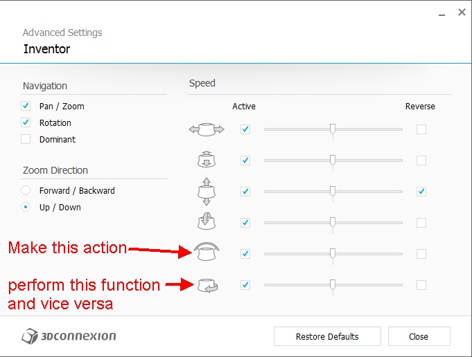

I think I have the same question...
I want to:
Anyone know of a way to do this?

Hi Trevor,
you can do this only by editing manually your configuration file.
The file you have to edit is the XML file for your application (here: Inventor.xml) in the %APPDATA%\3Dconnexion\3DxWare\Cfg folder.
The section you have to edit is the <Devices> </Device> section for your device.
Code: Select all
<Devices>
	<Device>
		<Name> your_device </Name>
		<Axis>
			<Input>
				<ActionID>HIDMultiAxis_Ry</ActionID>
			</Input>
			<Output>
				<ActionID>HIDMultiAxis_Rz</ActionID>
				<Reversed>False</Reversed>
			</Output>
			<Input>
			</Input>
			<Output>
				<Reversed>True</Reversed>
			</Output>
		</Axis>
	</Device>
</Devices>
You have to change the value in the <Output> <ActionID> tag and for the HIDMultiAxis_RZ the value for <Reversed> (from False to True).
See as well here for an explanation.
