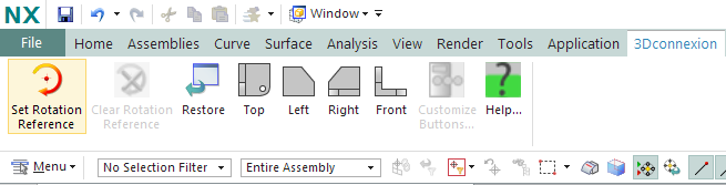

I'm facing the same problem as described above and i've tried all the fixes.
me and 50 colleagues would like to know how to fix the customize buttons functionality in NX9.0.1
Our systems all run windows 7 Enterprise
the problem occurs both in NX native environment as in managed mode via teamcenter.
I've already contacted the Siemens helpdesk and they have send some dll's with adjustments but without succes.
the 3Dconexxion hardware we used:
- space pilot pro
- space pilot
- space pilot pro
- space pilot

Re: SpaceExplorer and Siemens NX 8.5: buttons not working
Hello berdir,
which driver version do you have installed?
I recommend to use either 3DxSoftware 3.17.8 or 3DxWare 10.0.22 (the driver for the SpaceNavigator).
It is important that the environment variable UGII_3DCONNEXION_LIBRARY is set. This is usually done in the file ugii_env.dat, but you might have your own customized one. Please check. If you have problems to find out let me know.
