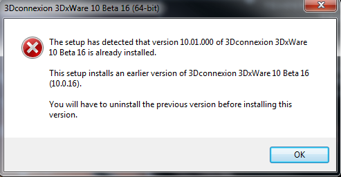

Re: Map only the SHIFT key
Hi Jim,
I have a question. The guy from support at 3dconnexions told me to download the Driver 3DxWare64SPP_v10-0-16_r1544 but I get some error. Which is clear.
But know.. what I can do?
Unistall the drivers I have now in install an old version just to see if this old driver works ZBrush?
HM!
HM!
LOL... i just gave a try...
Ok I will use the normal driver release on 16.05.2014
Well that driver (3DxWare 10 for Windows (64-bit)) doesnt work on ZBrush.
Ok lets give up again a let us forget ZBrush...
