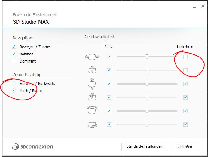

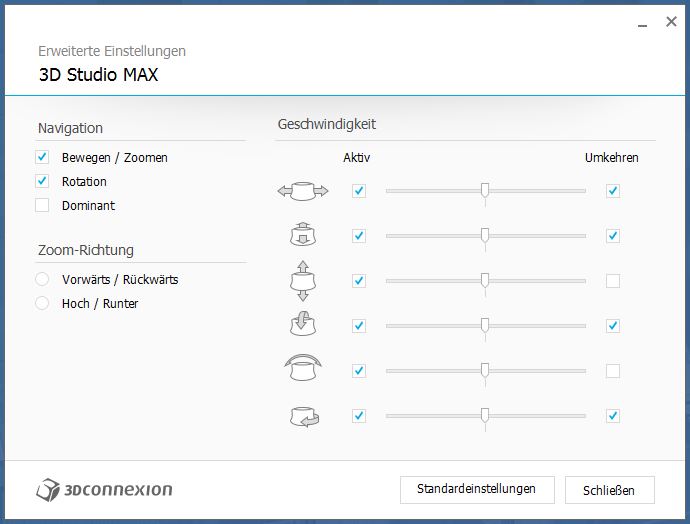

The new driver version 10.1.0 does not work like older versions properly.
It is not possible to set the zoom direction to UP/DOWN and REVERSE the directions of the gear.
Somehow the settings work like radio buttons. When I set the behaviour to REVERSE, the zoom direction disappears completely.
Please see the attachment.
In other posts I saw some tipps on editing the xml-file.
Could someome please check this. It´s impossible to work with this strange behaviour.

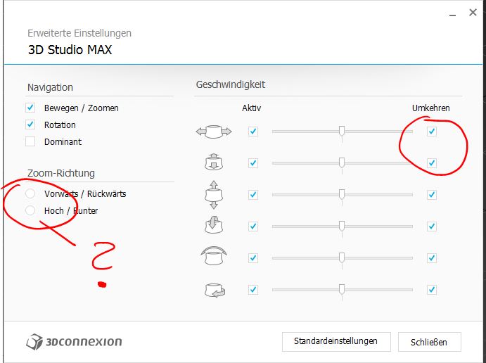

Thank you Fred, after tweaking the XML my favourite settings are back again.
It works fine now, despite the zoom direction is not shown in the properties.
Zoom Direction is missing

Re: 3dxware 10 vs 3DS Max 2015
Post by UtaSH »
Hi Alpenshiva,
the zoom direction isn't displayed anymore as your settings do not apply to any of the directions. ;-)
