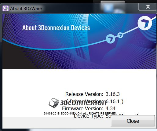

My Space Mouse Pro works "almost" perfectly in Max 2014. The exception is a lag when switching to new viewports when selecting objects. I had to try different versions until I got one that works. Problem now is the driver doesn't let me assign keystrokes to the alt, esc, shift buttons in Rhino.
Here is the version that works for Max 2014: 3.16.3 Driver version 6.16.1 Firmware version 4.34
