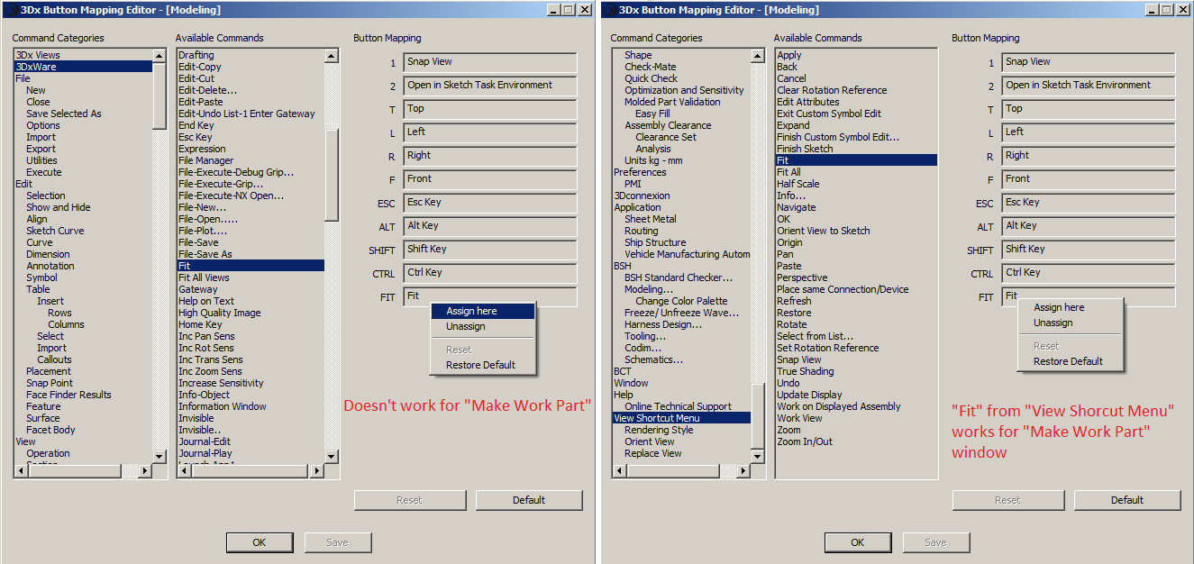

In part mode and assembly mode all buttons including "Fit" works.
If i make a part "Make Work Part" in assembly, all buttons except "Fit" works.
If i make a part "Make as Displayed" in assembly all buttons including "Fit" works.
I tried everything but couldn't get a solution. Opening a window with "Make Work Part" kills the "Fit" function.

I finally solved it.
Assigning "Fit" from "3DxWare" is default but doesn't work for "Make Work Part" window.
I assigned "Fit" from "View Shorcut Menu" so it works now.

Hi tolga,
note that you have a different mapping for each environment in NX.
