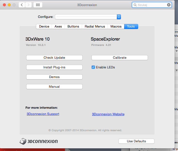

Dear All,
please help. I have 10.10 Mac OS X installed, and I have had installed 10.2.1 Mac drivers for SpacePilot USB. Since then Space Pilot is not working.
The system can se the hardware so is preference panel of 3DConnexion, but the device stopped.
When I plug and unplug the device the LED is flashing once. WHen I restart system the device has LED turned on, when the drivers are loading after logging the LEDS go off.
Can not use it in any app.
This behauviour does not change whenever the SP is connected directly to my MB pro. or via LCD or via USB hub (powered).
Please help.
B.
Drivers Pane:
Zrzut ekranu 2014-11-17 o 15.53.45.png (76.95 KiB) Viewed 9451 times
System USB devices:
Zrzut ekranu 2014-11-17 o 15.52.40.png (189.63 KiB) Viewed 9451 times
