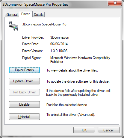

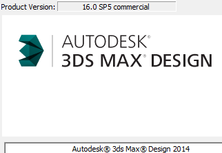

Hello All,
I have recently upgraded my version of 3ds Max Design from SP 0 to SP 5. My Space Mouse Pro was working well with the initial install of 3ds Max prior to the upgrade, but now it seems to be not working. Thinking that I needed upgrade my drivers, I upgraded to 3DxWare 10 for Windows 7 64 bit. That did not help solve the problem however. Also, I'm not too sure if the driver upgrade stuck or not. When I installed them, the device manager shows the driver for the SpaceMouse Pro as 1.3.0.10403, with a date of 06/06/2014. The 3DxWare 10 for Windows 7 shows a version number of 10.2.0 on the website (http://www.3dconnexion.com/service/drivers.html), with a release date of 11/14/2014. Not sure if I'm looking in the right area or not for the driver details or not.
Any help would be greatly appreciated.
Thanks,
Jeff
SpaceMouse Driver Detaisl

3ds Max Design Build Number

We have found a problem with the plugin for 3dsmax and 3DxWare 10.2.0. For 3dsmax 2014 the plugin is not loading. In 3dsmax the process how a plugin is loaded was changed and we have a problem with version 2014. For 3dsmax 2015 there are no known problems; the plugin is loading.
We are tracking this issue internally with bug #6815. I will inform you if we have a solution or if we find a workaround. In the meantime please install our previous version of the driver 3DxWare 10.1.4. This version is available on our download site for legacy drivers.

Bug #6815 is marked as fixed in 3DxWare 10.2.1.
