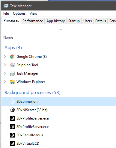

The two 3DxProfileServer.exe instances is expected in some cases but we don't recognise the "3Dconnexion" item.
Can you please confirm the processes listed in Task Manager?

L_Plum
Posts: 7
Joined: Mon Jan 24, 2022 11:25 am
Re: Auto-scrolling issues since installing Spacemouse Wireless
Post by L_Plum »
I have taken a snip of task manager, please see below
Task Manager.PNG (17.66 KiB) Viewed 16917 times

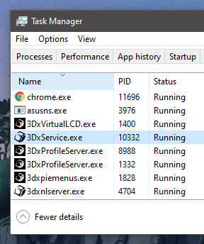

L_Plum
Posts: 7
Post by L_Plum »
Looking at the details tab for task manager and it would seem that 3Dconnexion with a white symbol is a different name for the 3DxService. Please see the 2 below images
Task Manager 2.PNG (40.82 KiB) Viewed 16916 times
I created a dump file of 3Dconnexion on task manager, which saved as 3DxService.DMP
