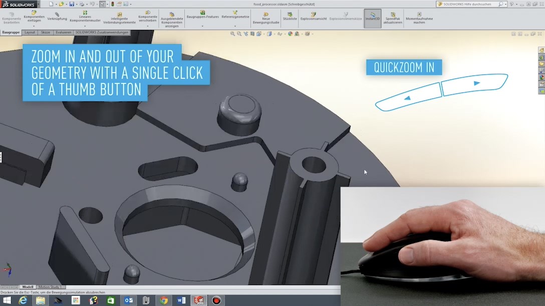

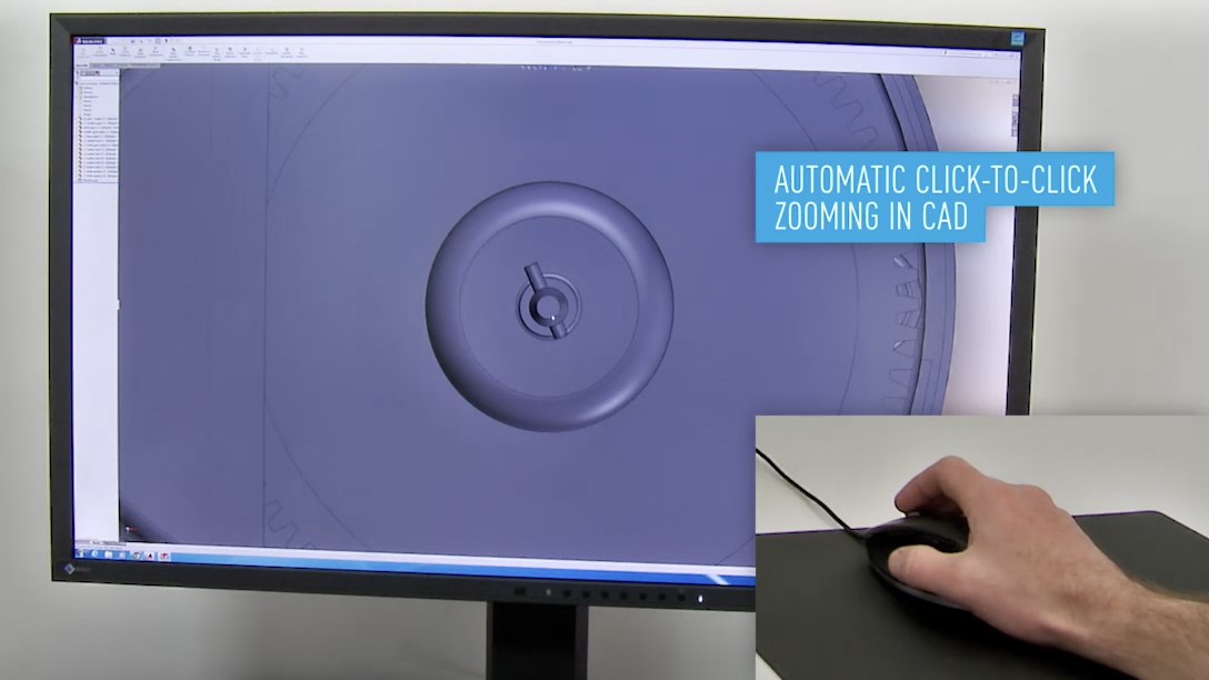

As for your issue regarding rotation with CadMouse in SOLIDWORKS, use SpaceMouse/SpacePilot Pro to rotate the 3D model. The CadMouse is designed to pan/zoom in 2D drawing, 3D model, scroll in office applications like spreadsheet application, word processing application. There's no mention of 3D rotation in the product specification/introduction of CadMouse, the demoed videos of CadMouse only shows pan/zoom in SOLIDWORKS, along with 3D rotation with left-hand SpaceMouse Pro.
luping
Posts: 1114
Re: Problem with 3D Connexion CadMouse in Solidworks
Post by luping »
CadMouse intro scroll.jpg (69.43 KiB) Viewed 4307 times
CadMouse intro zoom.jpg (100.57 KiB) Viewed 4307 times

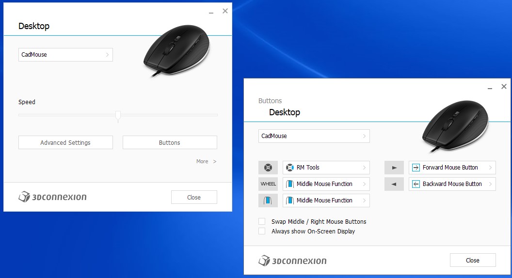

I would like to thank you for your replies 1st and foremost. But, if this mouse wasn't designed to rotate, why is it FULLY PROGAMABLE?
Screenshot 2022-05-01 131036.jpg (73.1 KiB) Viewed 4225 times
You have though reminded me that the mouse has a center button that by default is set to rotate! So, I will use that when my left hand is not using the Space Pilot Pro. :roll:
