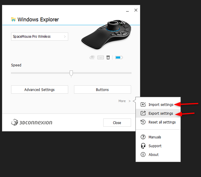

Export your 3Dxware settings in your workstation, and copy the resultant file to your private laptop and import it to your 3DxWare driver, if you use the same model of 3Dconnexion equipment for the workstation and private laptop. You may have to backup all the 3DxWare settings/configuration of your private laptop at first if you regret such change. There's the 'Export Button Configuration only' option for extra notice.
'Reset all settings' may also be another option.
