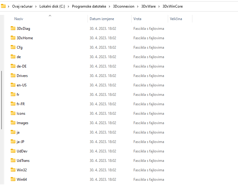

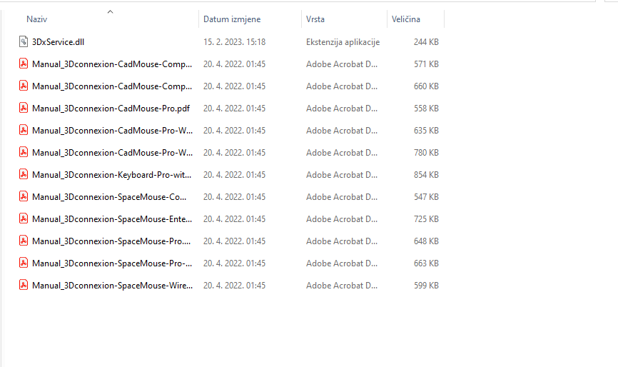

Hello Moderator
Yes I found the "en-US" directory in this path location, that's the place where I installed the application too. Also I've found that 3DxService.dll folder in it. But still when I click 3DConnexion app it gives me same error.
I've attached some screenshots.

Re: Unable to load an 3Dxservice.dll resource DLL
Your Windows language is set to Croatian?
I'd like to see your %localappdata%\3Dconnexion\3DxWare\3DxService.l* files, if you have any.
If you don't have any, I'll need to tell you how to enable them.
