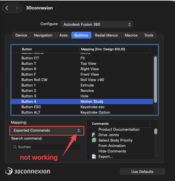

No.new ones - SpaceMouse Pro Wireless (Bluetooth Edition) are working at all yet?
The 3Dconnexion implementation for macOS is not really successful. I am disappointed. I wonder why this is in the system settings and cannot be managed in a separate, uniform, and platform-independent app.

The commands stored in the default configuration do work, however. But you can't change them and adapt them to your personal way of working, which is supposed to be the whole point.
By the way: Customizing the CadMouse Pro Wireless doesn't work either.
Re: Not working in Tahoe at all
Mapping is not working.
