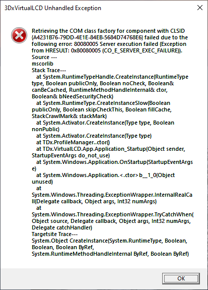

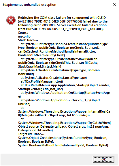

I've been hitting issues with windows - bunches exceptions being thrown - can't open settings.

I cannot open Settings from the 3d Connexions home. clicking on the app either does nothing, or shows the first exception dialog. I cannot retrieve my serial number. I am on the latest drivers on your site.
I will occasionally and periodically get the other two exceptions so long as the spacemouse service is running.
I have added an exception for the entire "C:\Program Files\3Dconnexion\3DxWare\" folder to my antivirus with no effect.
I have run "3dxrepair" (and restarted of course) and it made no difference.
Running the Viewer will work, but I will still get those errors during viewer startup. Once I dismiss those exceptions, the input of the spacemouse does work.
Running the "Training" app has similar effect. Exceptions, but I am able to use the inputs.
I cannot run the "Demo" app at all - similar exception.
I can run "chicken", "Cube3d", and "Jet", and "3dxTest" perfectly fine - and the mouse works fine within those apps.
spacemouse error 3.png (31.41 KiB) Viewed 740 times
spacemouse error 2.png (31.96 KiB) Viewed 740 times
spacemouse error 1.png (5.46 KiB) Viewed 740 times

I've uninstalled the drivers and went for driver 10.9.9.721 - everything is peachy keen now..
I will try to update the drivers to the latest version and advise

Upgrading to the latest drivers after installing v 10.9.9 worked fine - I'm not sure what happened when I tried installing the latest drivers first.

Hi ThatRobHuman,
With newest driver 10.9.12 you need install latest supported Visual C++ Redistributable, you can find it here.
This problem will be fixed with newer driver.
