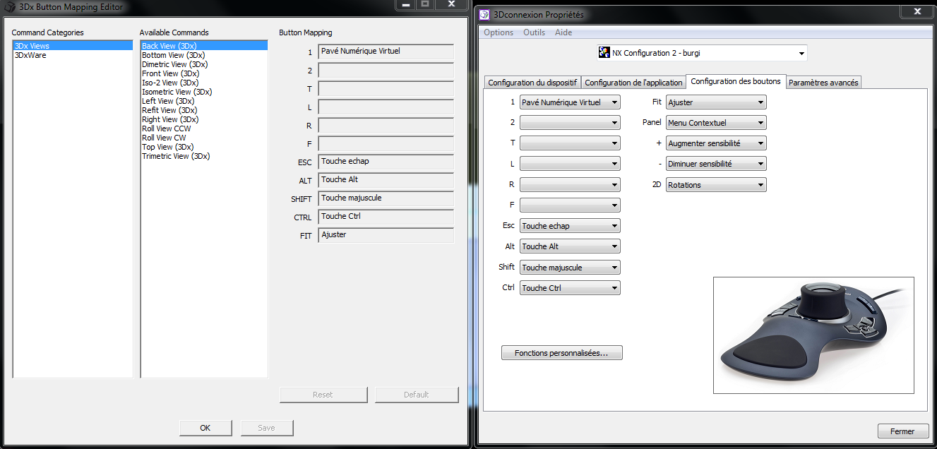

I tested NX and Space explorer to an other computer and I have exactly the same problem.
Software installed : 3DxSoftware64_v3-17-7_r1650.exe
Please, see attached file.

- Capture.PNG (178.66 KiB) Viewed 18672 times

I put the UAC at the minimum and i am now abble to use 3Dx Buttom Mapping Editor. This is the only solution i found.

Finally, I found a solution by changing UAC level. Now, i'm able to map buttons.
