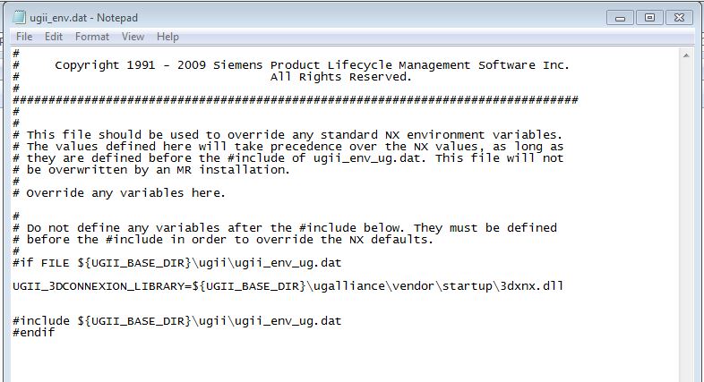

I am having this same problem. NX9 is working fine. In 7.5 the button mapping is still greyed out. This is what I set in the ugii_env.dat
- Attachments
- ugii_env.dat.JPG (76.79 KiB) Viewed 14132 times
Re: SpaceExplorer and Siemens NX 8.5: buttons not working
Hello Agville,
which driver do you have installed? Our latest driver is 3DxWare 10.2.3. You can download it here.
We need the log files from an NX 9 session (addin loaded) and one from a NX 7.5 session where you have problems with the addin. I will send you a PM with an email address to which you can send the files.
