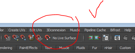

2015 Maya on the Laptop and the drivers are working fine but NOT the workstation - The SpacePilot doesn't even now Maya is there (LCD display panel).
There appears to have been some sort of install : -
some sort of install.PNG (15.49 KiB) Viewed 3267 times
But when selecting 'properties' I get this : -
error 1.PNG (3.63 KiB) Viewed 3267 times
