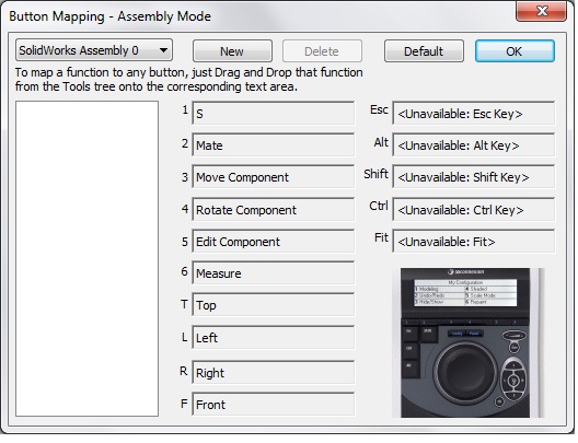

I just upgraded to SW 2105, svc. pack 4.0 (from 2013). The model will zoom, pan and rotate, but the assignable buttons do not work. The LCD display indicates the same assignments as I had in 2013, but they do not activate any SW commands. When I launch the button mapping window, the section of the window that has the list of SW commands is blank (see attachment below). The 3DConnexion Add-In box is checked.
Button Mapping Screenshot 01.jpg (69.76 KiB) Viewed 6938 times
Additionally, the Alt, Cntrl, Esc, and Shift keys do not work.

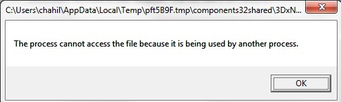

I have tried to update the drivers two ways, one is using the exe file you recommend, and the other is to use the"Update Wizard" in the 3D Connection Control Panel. Neither method worked, as there were errors that caused the update to fail.
Using the first method, I get eight errors where the program cannot get access to a series of files. Here is the first message:

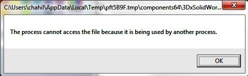

Some of these messages are for software I don't use, such as AutoCad. But one of the last messages is for SolidWorks:
Error 06.jpg (21.19 KiB) Viewed 6917 times

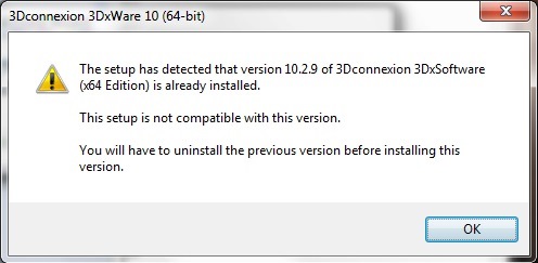

After eight of these errors, I get this message:
Error 09.jpg (30.47 KiB) Viewed 6917 times
I click "OK" and the installation terminates without actually updating the driver.

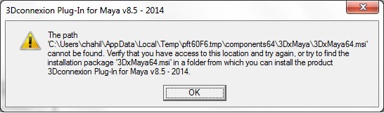

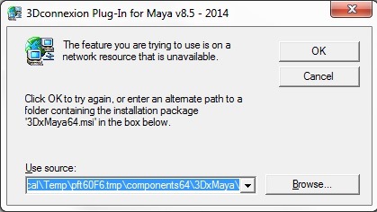

If I use the Update Wizard, the first error message I get is this:
Error 10.jpg (33.25 KiB) Viewed 6917 times
The path that the program is looking for does not exist; specifically the "pft60F6.tmp folder. I tried searching the entire C:\ drive to find the 3DxMaya64.msi file, and came up with nothing.
If I click "OK" after the above message, I get this popup:
Error 12.jpg (32.08 KiB) Viewed 6917 times
Any idea of where I can get this msi file and any others I need to point the Wizard to?
Thanks!

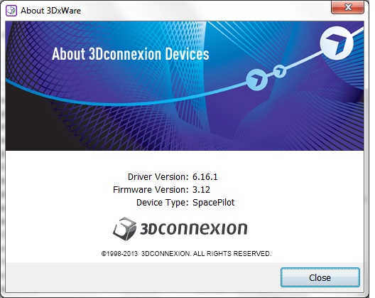

The new driver apparently installed, but with the same errors as listed in the second post above. Now the Control Panel "Uninstall or change a program" window shows the 10.2.9 driver. However, the 3D control panel "about" function shows the old driver:
About 3DXWare.jpg (63.36 KiB) Viewed 6873 times
The SpacePilot behaves the same-- none of the mapped buttons, nor the shift, esc, ctrl, or alt buttons work. The zoom, pan and rotate functions as before.

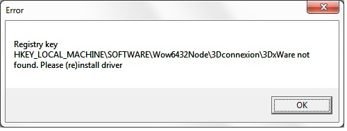

Well, that was a little clunky but finally it is working. I followed your procedure to remove the old driver and its references, which worked. When I installed the v10 driver, there were some errors as before. When I tried to run the driver, I got this error:
Registry Error.jpg (22.29 KiB) Viewed 6803 times
