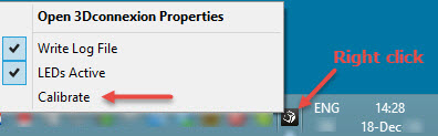

The option "Calibrate" can be accessed by right clicking the 3Dconnexion icon in the system tray. See this screenshot for explanation:
This is where you find the function "Calibrate".

Re: space navigator, works alone
Post by Victor Santos »
I found. I'll try.
