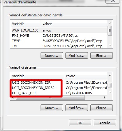

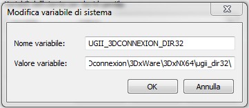

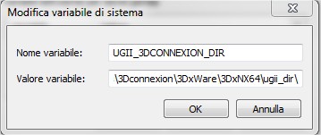

In attachment some print screen from my environmental variables.

The problem is that I haven't the environment variable "UGII_3DCONNEXION_LIBRARY".
Can you please help me to find where could be the problem?

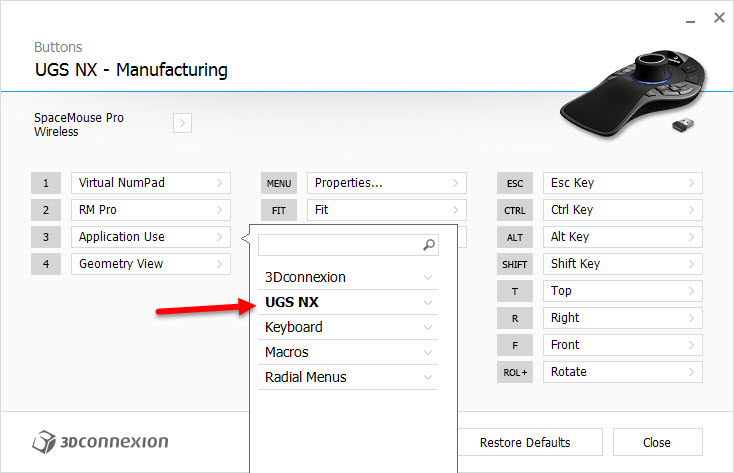

we have redesigned the driver and the plugin. You can now find everything in one place: in the driver panel. There you can make changes to the settings of sensitivity or the axes settings and you can map all the functions provided by NX in the driver, too. You should have an entry "UGS NX" in the button mapping drop down:
3DxWare 10 ButtonMapping.jpg (70.22 KiB) Viewed 14514 times

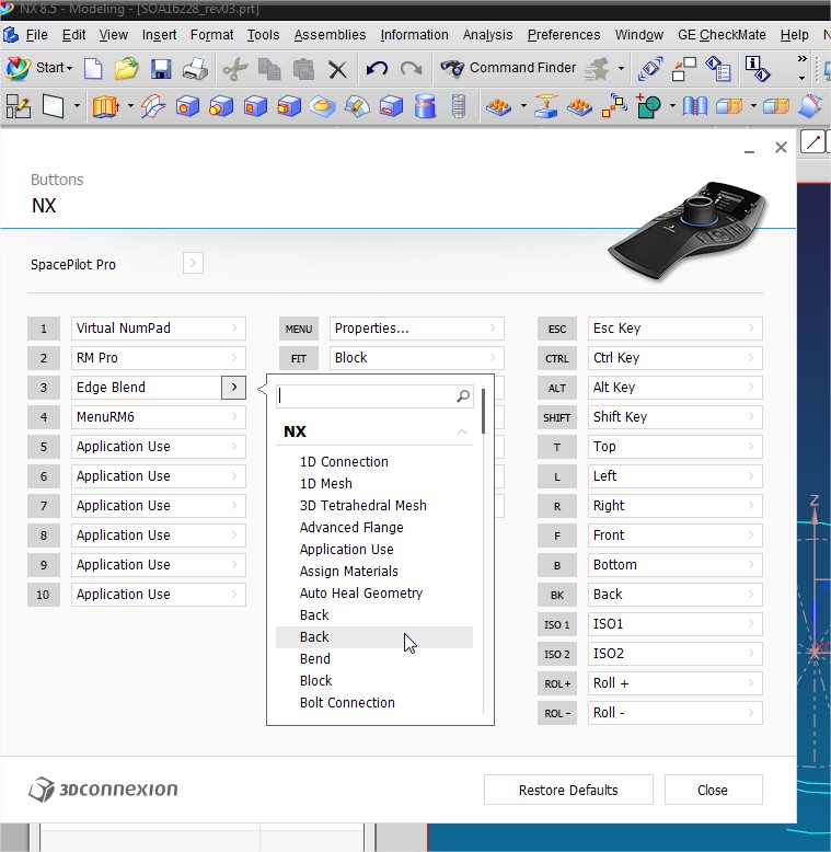

I've found this new feature in the new driver panel that appear when pressing "MENU" on my device, and I've tried to map some buttons (example edge blend or other commons operations), but when I press the relative button nothing happens in NX.
The problem seems to be that the device buttons don't give input to NX....no one button/functions work. I'm able only to rotate and move the model.

from the picture that you posted I have the impression that the driver doesn't recognize the environment that NX is using. There should be the name of the environment in NX that you are just working in.
I would need a log file from NX from you. I will contact you directly.
