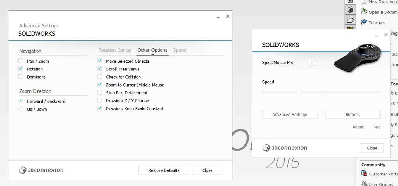

Hey T_Warris,
Open 3Dconnexion driver => Advanced settings => Other options => Move Selected Objects.
I believe this is what you are looking for.
Mitch
Mitch

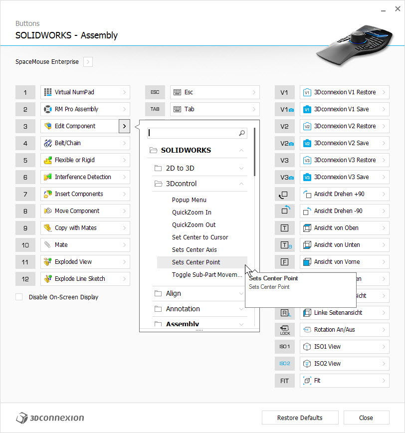

Thanks for the response. Not quite what I am looking for. On SolidWorks there used to be a 3dconnection toolbar where you could select a point on any object and it would pivot around that point. Without it, it's quite cumbersome to move around.

Hi T_Warris,
as the toolbar was removed by design you can now find this function available in the button mapping:
