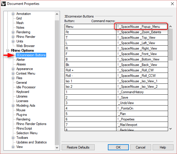

Hi richard.aubin,
We have had reports that the lag can be caused by editing the button settings for Rhino in the 3Dconnexion driver GUI. Rhino is a special case integration where the button mapping is done within the application. Please try removing the user file, and using the internal options exclusively:
  1. Close Rhino.
  2. Stop the driver (Start -> All Apps -> 3Dconnexion -> Stop Driver).
  3. Delete %APPDATA%\3Dconnexion\3DxWare\Cfg\Rhino.xml.
  4. Restart the driver (Start -> All Apps -> 3Dconnexion -> Start Driver).
  5. Use only Rhino button settings and camera control settings from popup menu
    2. http://docs.mcneel.com/rhino/5/help/en- ... nexion.htm
  6. Let us know if this solves the lag when switching applications.
