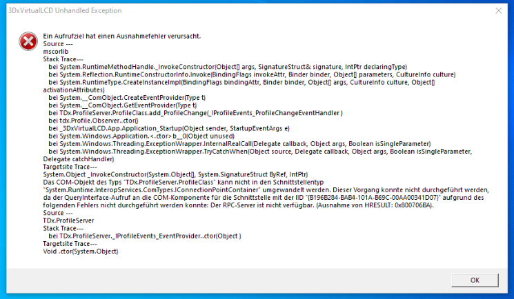

Well years later.
One of my Users has a kinda simmilar Error Message.
Funny thing is, he Uses the SpacePilot. It works fine.
The error pops up when logging in to the local notebook.
He uses the mouse only in a virtual system running SolidEdge and Co.
Screenshot of Errorscreenshot
