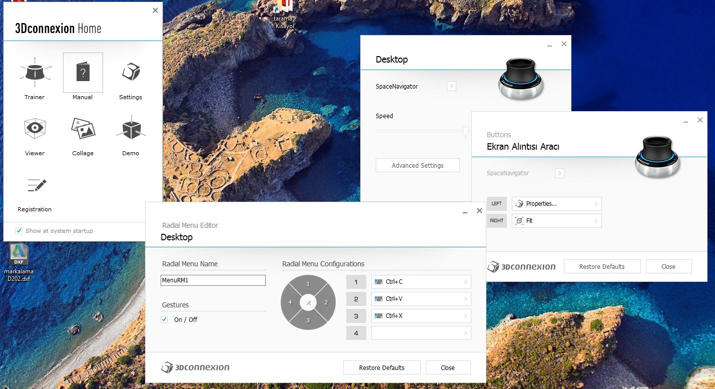

as you can see the desktop config when I click left button properties open but on right click nothing happens.
I've already done the cleaning up by reading another topic on forum.
I've also downloaded and installed 10.4.10 drivers.
I could not solve the problem.
I am having this problem on every program even on windows desktop.
I can not open any radial menu. buttons work on single commands but can not open radial menus.

The screenshot doesn't show if you mapped the radial menu to one of the buttons.... Please try it with something different than the Desktop.

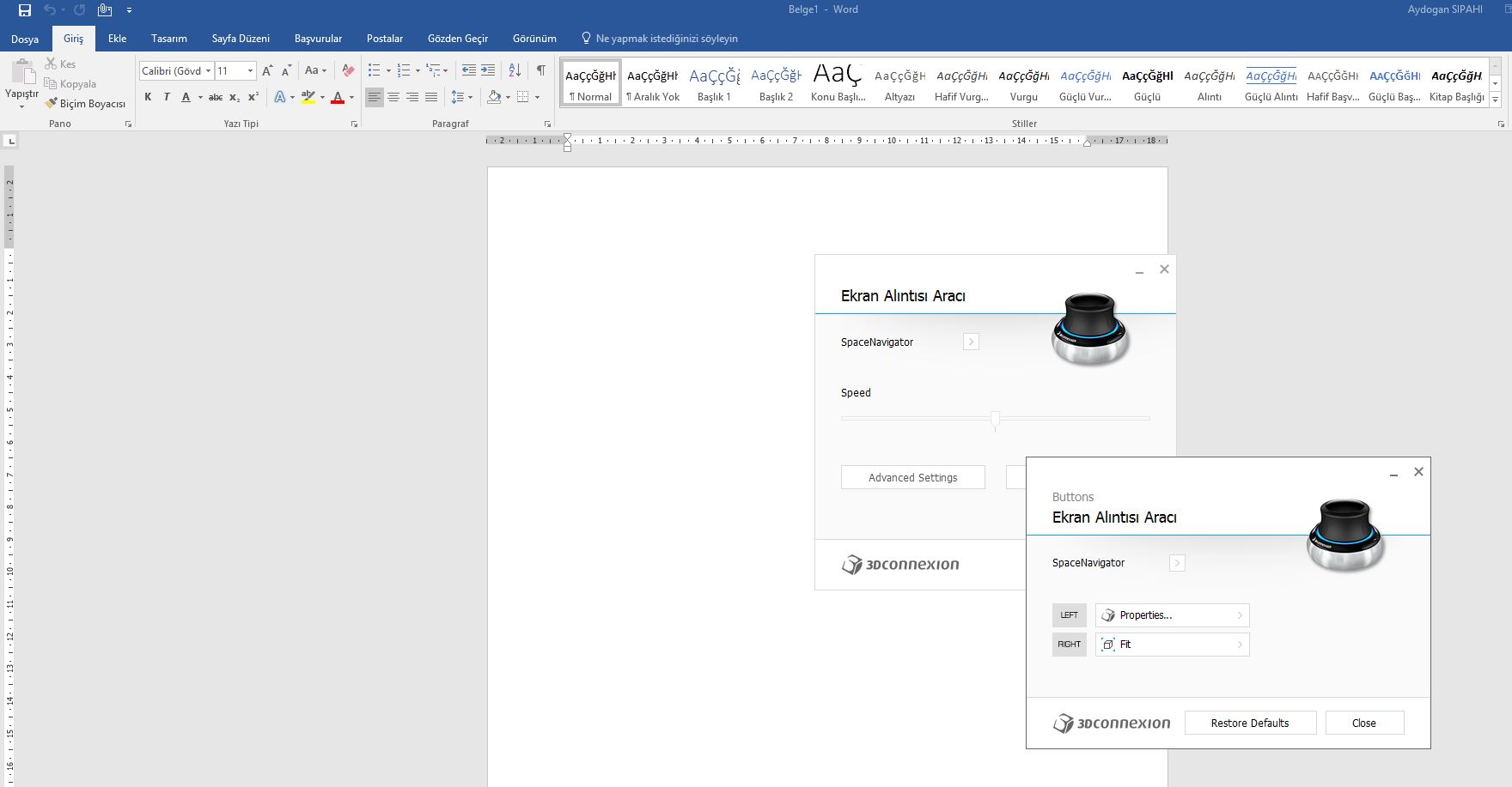

here are the screenashots of three different programs. buttons operate fine on single commands but can not open radial menus

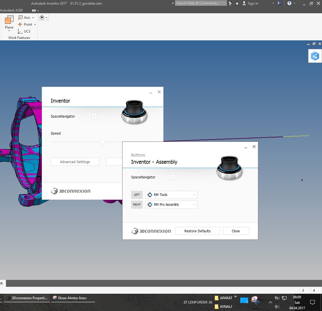

also cad programs

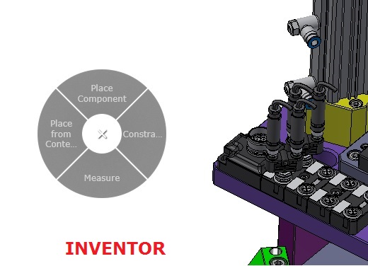

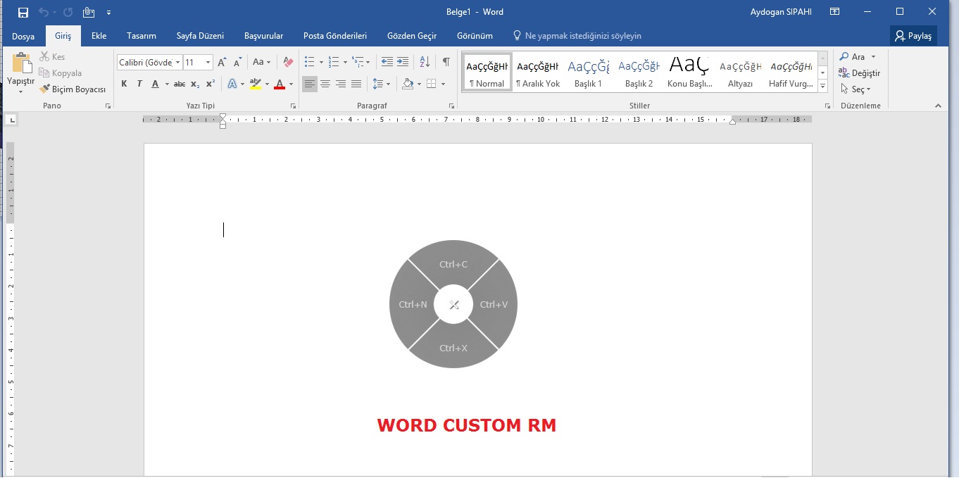

I've swapped OS language to English and it worked. you may see the attached Screenshots from different programs.
thank you again.
thank you and development team for your efforts.
thank you again.
