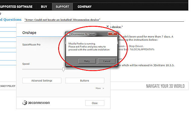

I followed your temporary fix, but ran into this problem (see attachment).
Any idea why the driver would need to install/access a certificate?

Hello JoanTheSpark,
the certificate is for the 3DxNlServer which is the interface for web-based 3D applications like Onshape.
