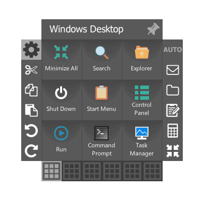

Grimmy
Posts: 6
Joined: Sat Aug 19, 2017 3:29 pm
Re: 8 sections radial menu barely usable :(
Post by Grimmy »
Hi everyone. In the end I built my own menu to improve on what we have. You can see a video here..
https://store.steampowered.com/app/1038000/Makross/
I'm hope many of you will find it as incredibly useful as I do :)
Cheers

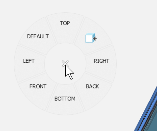

antonynealrobinson
Posts: 39
Joined: Tue Mar 29, 2011 12:47 am
Post by antonynealrobinson »
Hurrah, finally got a working 8 section radial menu in Creo by removing the User_Defined_Macros.png
radial menu.png (24.29 KiB) Viewed 15864 times
