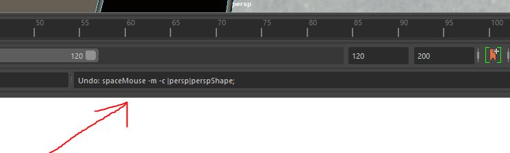

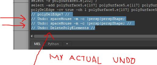

me too, here are screens

Boban wrote: Wed Feb 26, 2020 1:13 am me too, here are screens
Thanks Boban, I've seen yours already and there will be a fix for what you are seeing in the next release. I'd really like to see those from joker720, though, I suspect his reported issue has a different cause.
