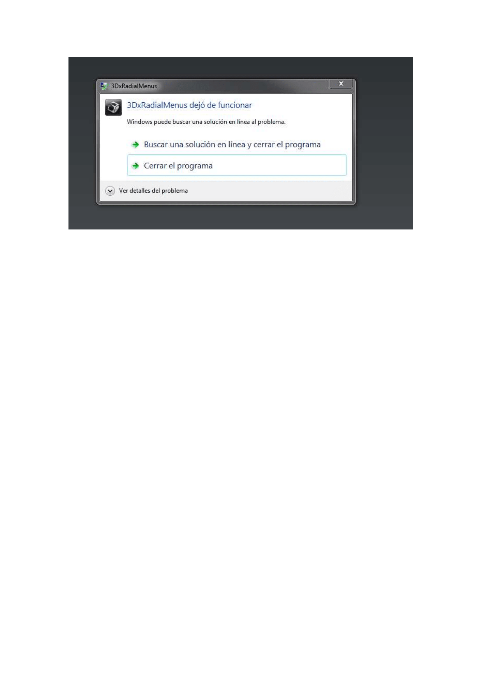

This is the error!!

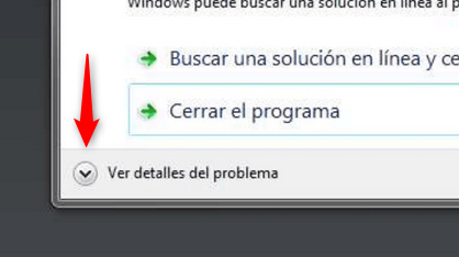

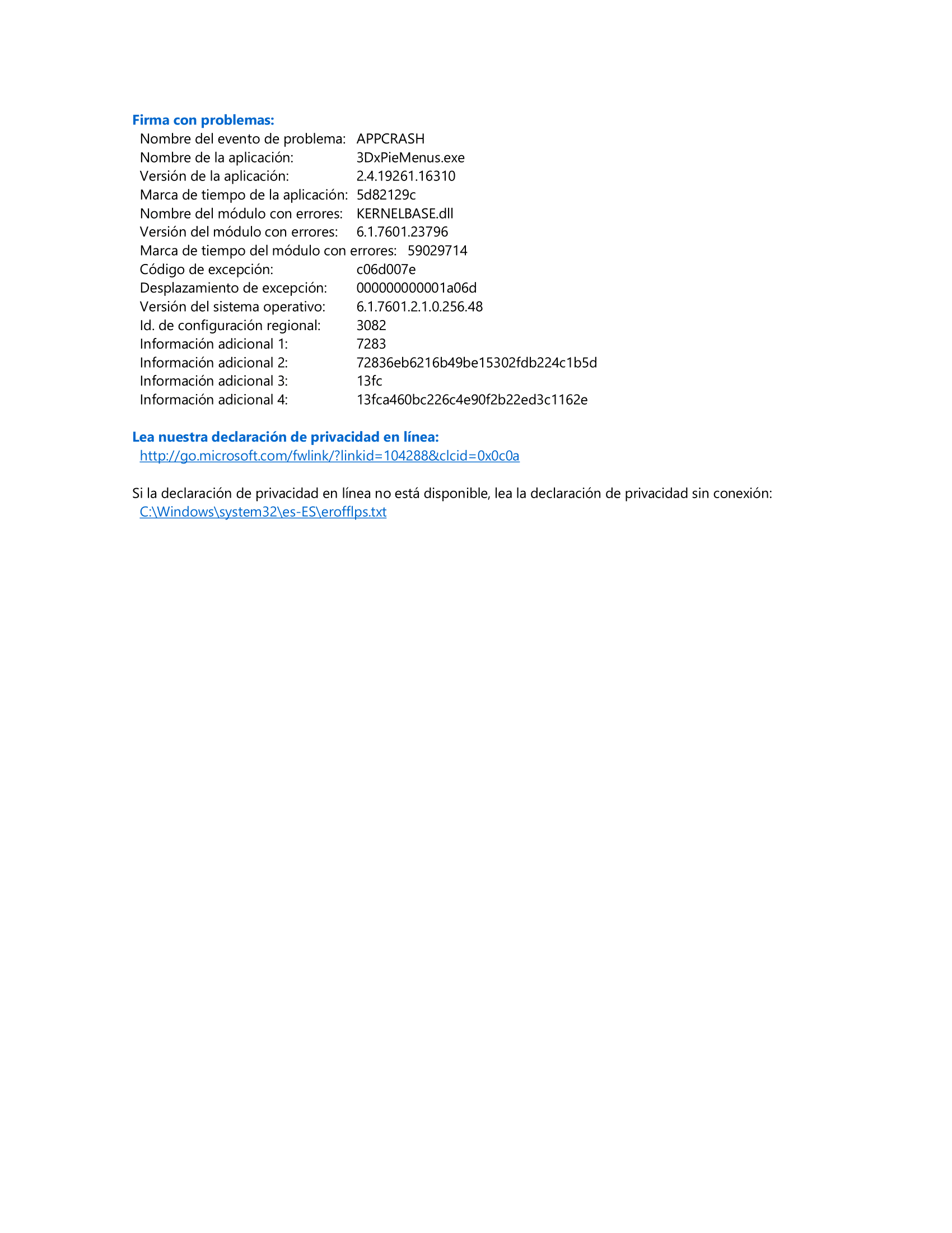

Click for detail of the crash.
crash detail.png (76.48 KiB) Viewed 5516 times

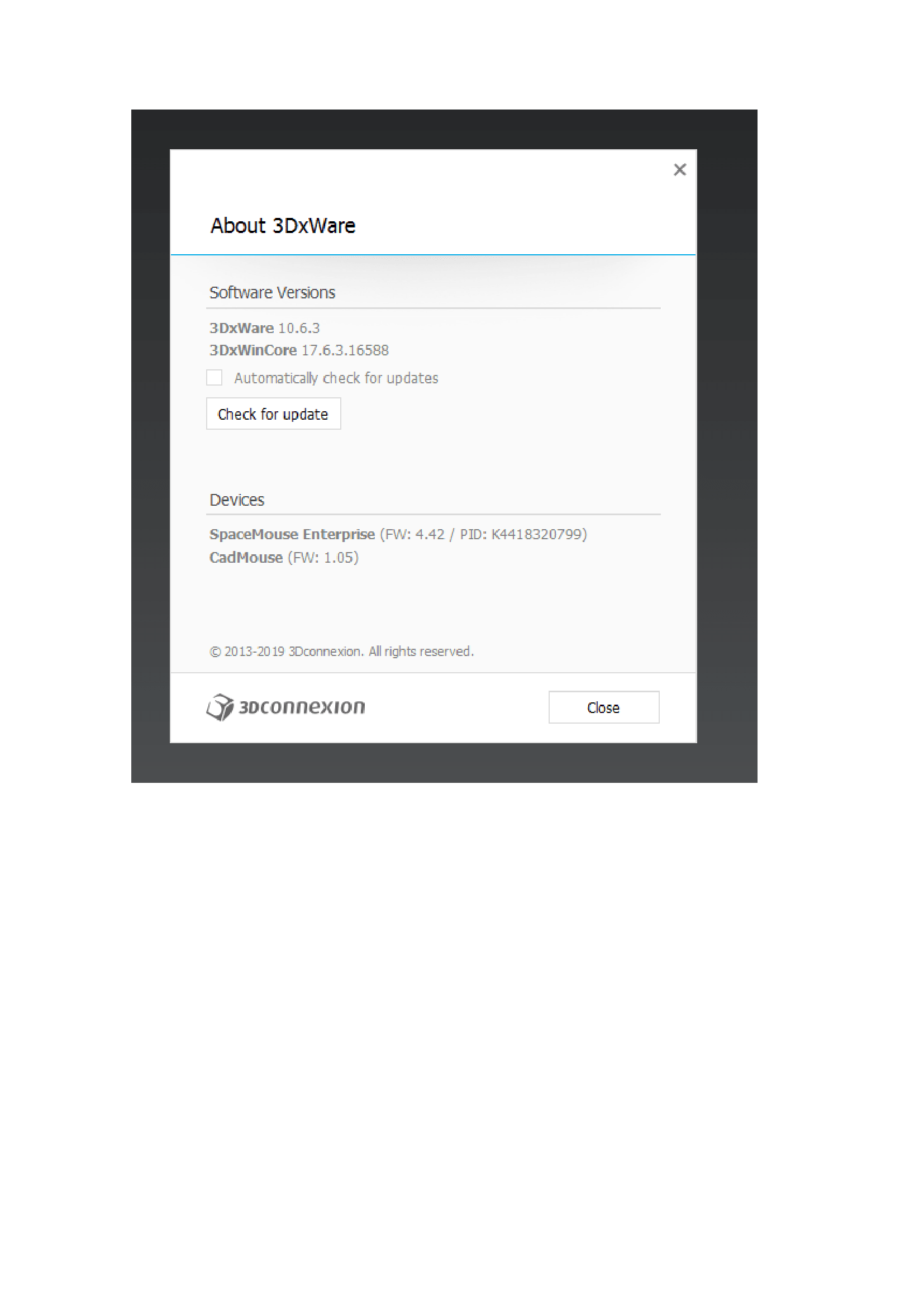

By the way, what's your 3DxWare driver version?
You're on Windows 7, may be the last possible version for Windows 7 is 10.6.0:
https://3dconnexion.com/us/archived-drivers/
