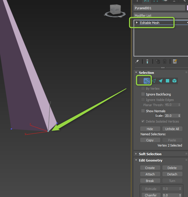

Hi jadactaq
I tried to reproduce the problem but it works as correct. I am using 3DxMax 2026 and 3xWare 10.9.8.715.
For example if Vertex is enabled, pivot point sets on the selected point.
Please explain if the problems is something else.
