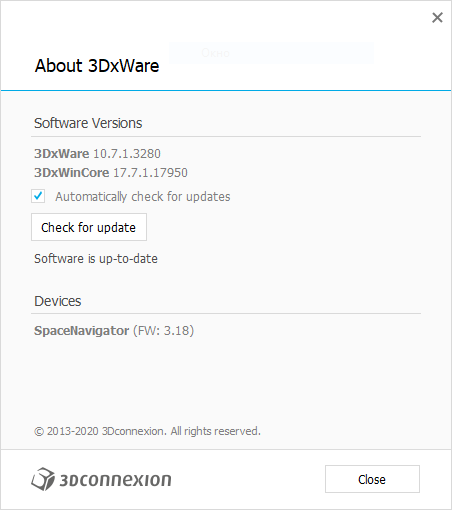

romanglebov
Posts: 2
Joined: Wed Mar 17, 2021 1:19 am
Re: 3ds Max 2020 Rotation Blur
Post by romanglebov »
Having same issue. 3ds max 2021, 3090. Latest drivers.
Без имени-1.jpg (204.43 KiB) Viewed 24975 times

romanglebov
Posts: 2
luping wrote: Wed Mar 17, 2021 6:31 am
romanglebov wrote: Wed Mar 17, 2021 1:26 am Having same issue. 3ds max 2021, 3090. Latest drivers.
Professional graphics card is recommended to work with 3ds Max, Geforce gaming card is not recommended.
I really don't think graphics card could be an issue here, as this blurring only appears when I orbit the scene with my Spase Navigator. Alt+middle mouse button does great. Also, your advice on getting a new 3d mouse, reverting to older version of 3ds max and using professional graphics card instead of 3090 make little to no sense.
