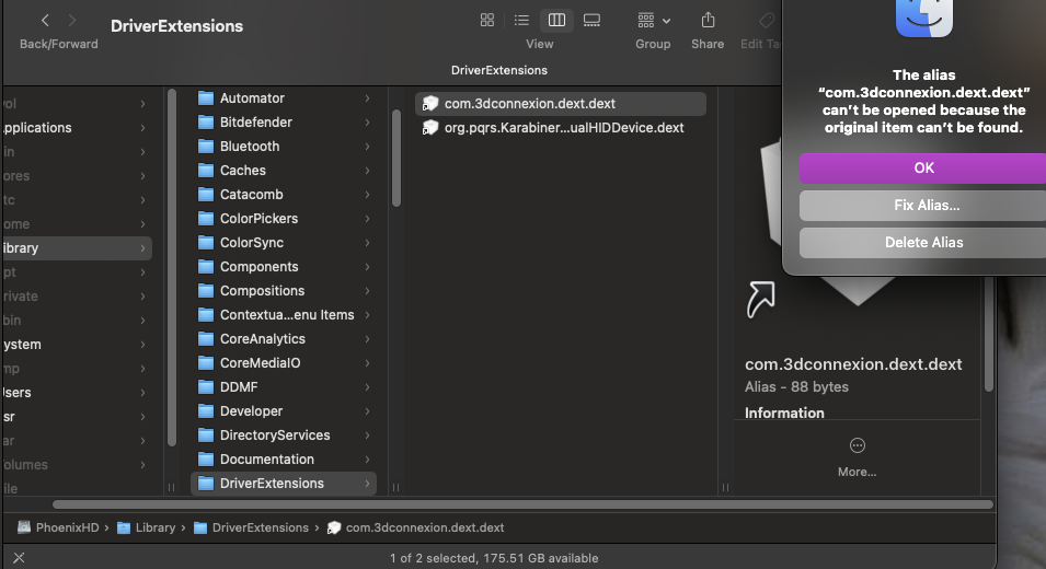

NOT sure this is relevent. i did discover a DEXT file that was a pointer i assume to the original one.. but it errors out and i can't delete the old pointer shortcut file even with sudo..

As for the earlier question. yes the 3dc helper is in launch..
see these screen shots though.

cjadams wrote: ↑Tue Jul 12, 2022 3:19 pm forced quit settings and rebooted...still no luck...
I just sent a private message with detailed instructions in an attempt to get rid of that symlink (which may indeed be blocking the driver installation). We're recommending to try to delete the symlink in "Recovery mode".

ngomes wrote: ↑Wed Jul 13, 2022 2:12 am
Sadly .... was able to ditch that stuck symlink... but uninstall / reinstall later.. still got only one allow not 2 and still showing the error in 3dconnexion home.. and here we are.. same as before.. it just really doesn't like me! - i sent you a followup msg..
