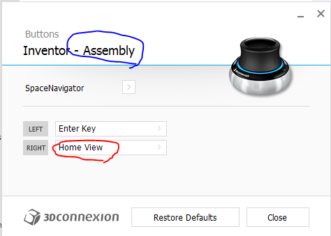

Also just in case it wasn't clear in my first post. I was unable to setup the 3D mouse buttons to work the same way they did before. There were two things I couldn't setup the same. The first was the "Home View" and many other button options did not exist under the Inventor specific options. The second issue was the driver no longer detected when Inventor was in an assembly/part/drawing/etc, so it was not possible to set different buttons for different areas of Inventor.
The attached picture shows the items that the upgraded driver did not have for me.

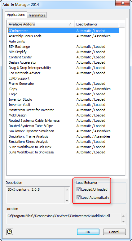

Hello pball,
the above means that the plugin for Inventor (3DxInventor) hasn't been installed or loaded. Maybe you could have fixed the problem by just repairing the installation?
You can verify in Inventor if the add-in is loaded by opening a file and selecting the Add-Ins button found on the Environments tab in the ribbon. In the first tab "Applications" you see the available add-ins listed. The second column there says if the add-in is loaded and it is recommended to be loaded automatically.
- Attachments
- In the first tab "Applications" you see the available add-ins listed. The second column there says if the add-in is loaded and it is recommended to be loaded automatically (see the bottom of the screenshot).
- enable_3DxInventor.png (47.65 KiB) Viewed 8473 times

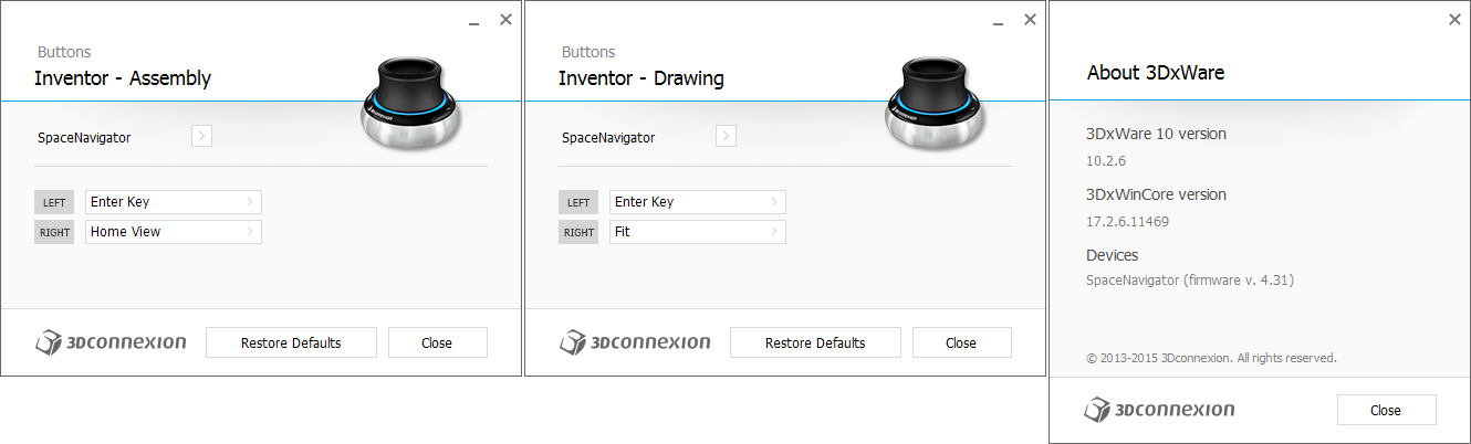

Re: Upgraded from 10.2.6 to 10.2.9 and only have issues
In the driver version 10.2.6 it is definitely possible. Here are screen shots of the settings when I was in two different Inventor files and the about info.dsadsF wrote:It was not possible to set different buttons for different areas of Inventor.
- Attachments
- different settings.png (49.38 KiB) Viewed 8441 times
