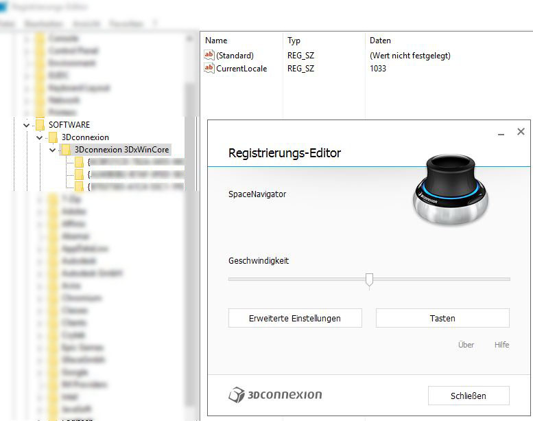

Help me Guys..
Hey guys i do as you do but it wont work, what im doing wrong ? Win 10..
And viewer and trainer in english but only properties in German !!!
Cheers
Cheers

- 1.JPG (74.8 KiB) Viewed 16016 times

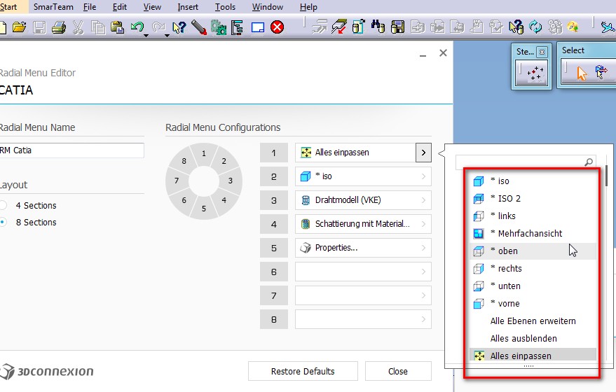

Hi Uta,
thnx for the hint but it didn't work in my case.
I use an English Catia on a German Windows7. I installed the driver also in English Language, but the Shortcuts for Catia are German and so don't work in my English Catia.
How can I change this? Nothing works. I'd really like to use the Radial Menu.
Thanks in advance
Stefan
Thanks in advance
Stefan
