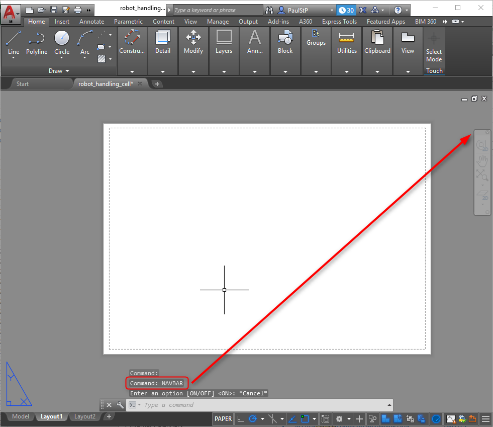

this is an issue with the navigation which had been implemented by Autodesk. We are tracking this issue with our internal bug number #7369:
No Navigation in Layout mode when navbar disabled, internally. When the navigation toolbar is disabled, 3D mouse movement is disabled in the Layout mode. In order to restore 3D mouse functionality, the NAVBAR command can be used to set the display of the Navigation Toolbar to “ON”.
Command: NAVBAR
Command: NAVBAR
