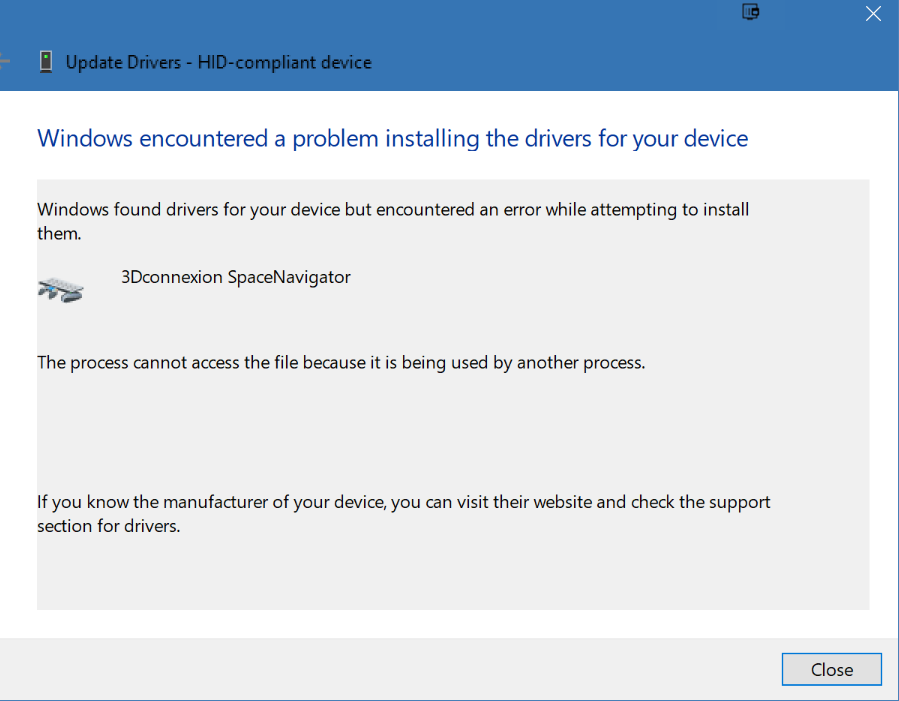

I unpacked the drivers and attempted to install the manually.
This is the true OS level error and not MSI related as there is no MSI engine at this point:

Ok here is a fix for folks running Windows 10 x64 fast ring )this was on 170513-2252
[*]unplug you space whatever
[*]open device manager
[*]from the view menu choose 'by container'
[*]from the view menu choose 'show hidden device'
you will now see sever greyed out 'space navigator items:
[*]expand each one
[*]delete the HID device
[*]delete the USB device
keep doing this until they are all gone, note the uninstall of each node can take quote some time - be patient, once they are all removed reboot the machine and run the latest x64 installer, it may take uptyo 15 minutes to finish the device install
you will know if you have been successful if you open device manager with hidden device and by container - you will see a 3DX_KMJ_01 device.
[*]now plug in your space whatever
[*]reboot machine
now everything should work
good luck
alex
(my suspicion is the co-installer DLL is funky / poorly constructed (not that co-installers are good at any time - they are unavoidable)
