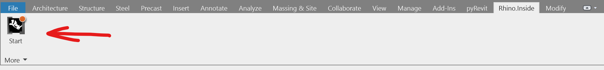

I understand the confusion, because it concerns one program hosted within another. The main issue still is that the moment I launch Rhino from within Revit, this freezes the 3dmouse within Revit's viewports. Meaning Revit by itself is fine, Rhino standalone works fine, but Rhino inside of Revit, specifically, causes the 3dmouse inputs to be completely ignored for Revit. It does not matter whether or not I close Rhino within Revit, as soon as Rhino.Inside.Revit is activated, I cannot navigate inside of Revit anymore. To be clear, if I want to use Grasshopper or any other features of Rhino.Inside.Revit within Revit, that will also break the navigation.
This button is the culprit .png (19.15 KiB) Viewed 4776 times
In Rhino.Inside.Revit, there used to be a problem with Rhino's viewport navigation in terms of movement speed. This speed and related settings, were different from Rhino standalone, but this now seems to be working correctly. So although I cannot navigate Revit Except from the missing "Navigation Modes" settings that does not exist for Revit and therefore won't work for Rhino inside of Revit.
