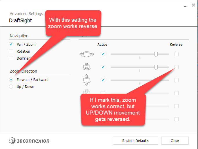

Hi,
I have had an issue for years with 3DConnexion spacemouse and Draftsight. The problem is that in theory you could edit the moving directions in advanced settings, but in practice its always bugged.
Example:
I want Spacemouse to behave the same it behaves in Solidworks drawing environment: You push forward, drawing goes further = zoom out and when you pull to yourself, it zoom in. You move to right, drawing moves right and so on.
No matter what settings I use, some of the directions gets reversed everytime, see the attached files. If I manage to get the zoom to work properly, Up/Down movement gets reversed. If I get Up/Down movement to work properly, the zoom gets reversed.
I have tried every single possible combination in the settings with 3 different computers and with multiple different versions during my career as an engineer and this problem has been there always. For a while we had Autocad as 2D program and with that spacemouse worked properly.
This whole thing wouldnt be a problem if I had to use only one of these programs, Draftsight or Solidworks, but I have to switch between them on daily basis, so basically I cant use the spacemouse with draftsight because it behaves wrong and it cant be fixed in settings.
Example:
- Attachments
- draftsight_pic.png (47.35 KiB) Viewed 53122 times

Hi UtaSH, thank you for your reply.
I am using Drafsight version 2020 SP1.
I am using the newest 3DConnexion drivers available.
I had file named "DraftSight_S80.xml" in the folder you described and deleted that. After the deletion I had to make the settings again, but the same bug still appears. No matter what settings I use, one of the movements gets reversed and it is not behaving the same as in SolidWorks.
