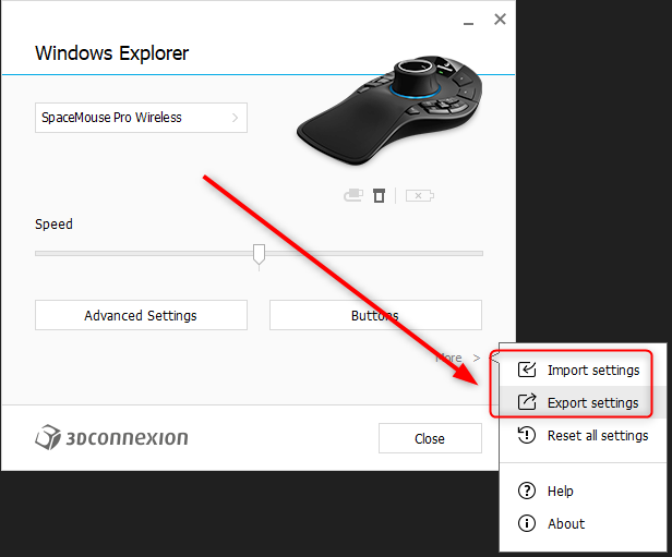

Do you mean this 3DxWare configuration export and import thing?
Or you simply meant NX role?
