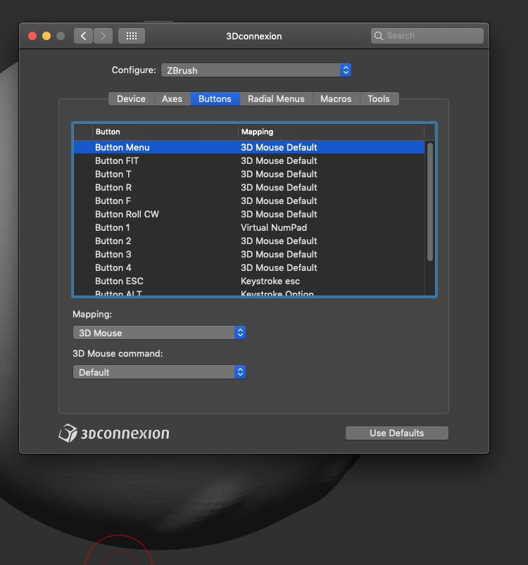

Lots of news about Zbrush/Spacemouse integration but I don't see zbrush listed in the dropdown of supported applications. see image.
In the Properties window, I tried: Configure/Add application/ then added Zbrush, but that did did not populate buttons like "fit" with zbrush commands.

I don't think you missed anything. We do not yet have a default configuration for ZBrush on macOS but it is likely that we will be adding one.
Client applications do not require a specific driver configuration to work well.

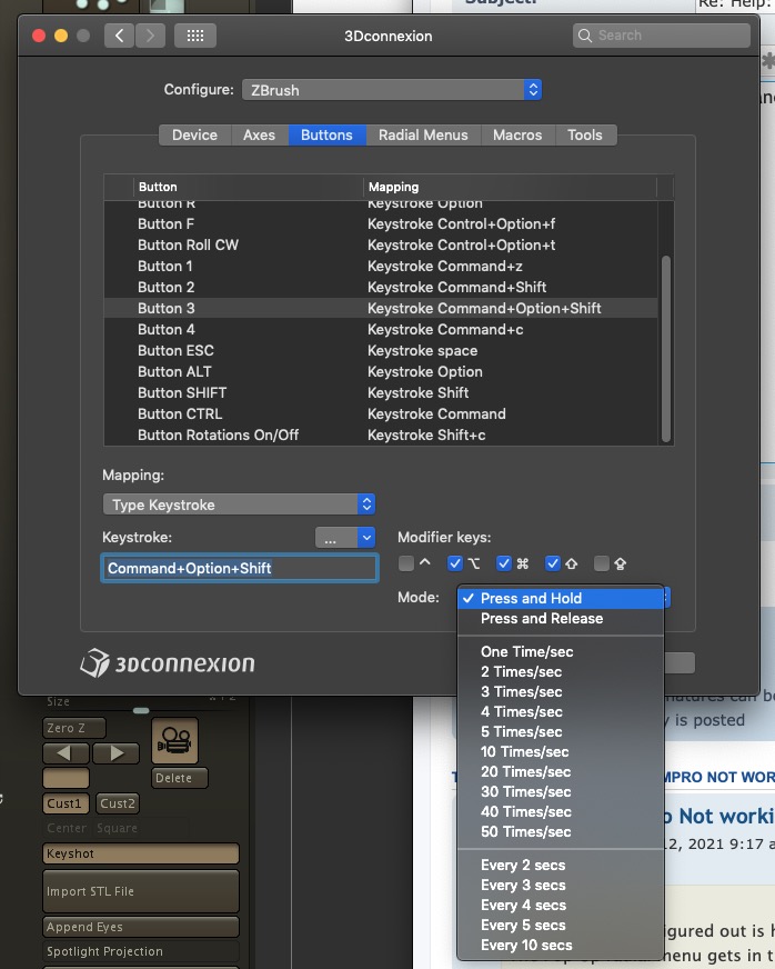

Thank you. I was able to remap buttons after creating some new zbrush hotkeys. I'll look forward to seeing how the zbrush integration works and what was adopted as default.
One thing haven't figured out is how to use the top buttons ( 1-4 ) while simultaneously pressing and using the stylus or mouse.
The Pop Up radial menu gets in the way and the function doesn't seem to work.
Any way to work around this? cmd-alt-drag for example.

You want to press-and-hold one of the "programmable" buttons (those labelled "1" to "4").
By default, press-and-holding any of those buttons will open the "on-screen display" panel (as shown on the screen shot above). I can't recall if there is a setting to control this behaviour and I do not have a machine quickly check. Go to the "3Dconnexion" pane in the System Preferences and see if you can find a check box to control the OSD panel.

I don't see any OSD controls. There is a "press and hold" and "press and release" Mode option for the buttons, but that doesn't seem to help.Go to the "3Dconnexion" pane in the System Preferences and see if you can find a check box to control the OSD panel.

I just confirmed. On the Mac, we don't have a user interface to disable the opening of the OSD panel on a press-and-hold action of buttons "1" to "4". If you wish to keep a button down, you will need to use another button for the time being.

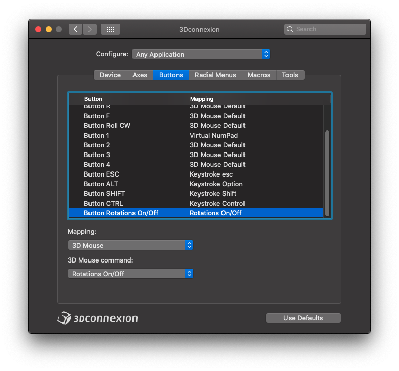

Rotations do not work with "any applications" either.
Also with "any application" configuration, the "R" and "Button Rotations On/Off" do not work.

Below is a screenshot with the default mapping for the "Button Rotations On/Off.

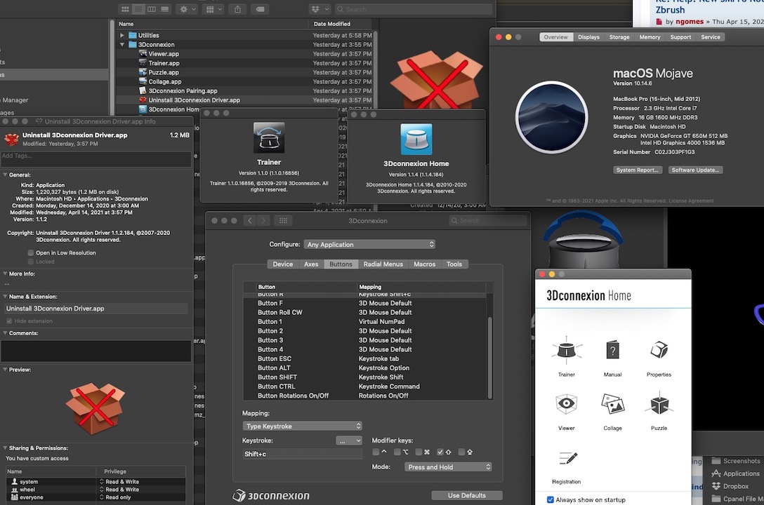

PS Everything was working fine early yesterday. At some point I used Export Configuration and checked the "Export All Settings." And later imported that config file. Not sure if that coincided with the issue though. Like I mentioned, since it stopped working, I uninstalled and reinstalled the driver and the Zbrush config was listed without any action on my part.

I don't recognise that version.
You will find the full version details in the "Tools" tab of the "3Dconnexion" pane in System Preferences.
Try the following process to reset the user driver settings.Everything was working fine early yesterday. At some point I used Export Configuration and checked the "Export All Settings." And later imported that config file.
Note you will lose all your changes to the driver settings.
- Close System Preferences, if opened (this is important).
- Open Activity Monitor, select "3Dconnexion Helper" and quit the program.
- In Finder, go to menu "Go", select "Go to Folder..." and enter "/Users/<your user name>/Library/Preferences" (without the double quote characters).
- Drag the "com.3dconnexion.mapplings.plist" to Trash or any other location if you wish to back up the file (this is where the user changes are stored).
- Go to System Preferences and open the "3Dconnexion" pane (this will relaunch the driver).
- Check if the issue is still reproducible.
