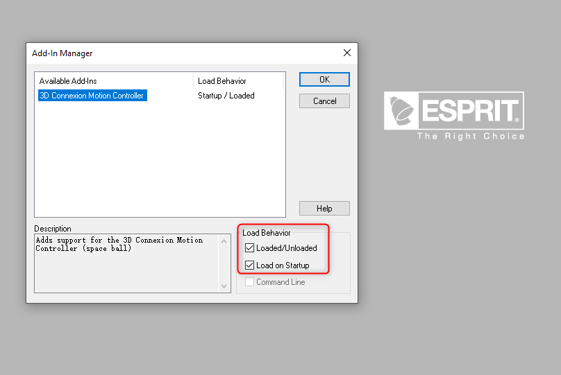

Allow the 3DxWare 3Dconnexion plugin to autoload in the add-in list.
luping
Posts: 1114
Re: problemi con esprit tng , dp tecnology
Post by luping »
At the ESPRIT TNG application window, go to menu bar's File>Add-Ins, at the Add-in Manager window, go to Load Behavior section, tick "Loaded/Unloaded" and "Load on Startup", then along with 3DxWare driver installed, you should be able to use SpaceMouse Compact in ESPRIT TNG.
