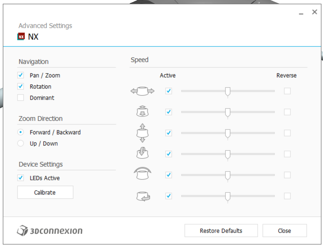

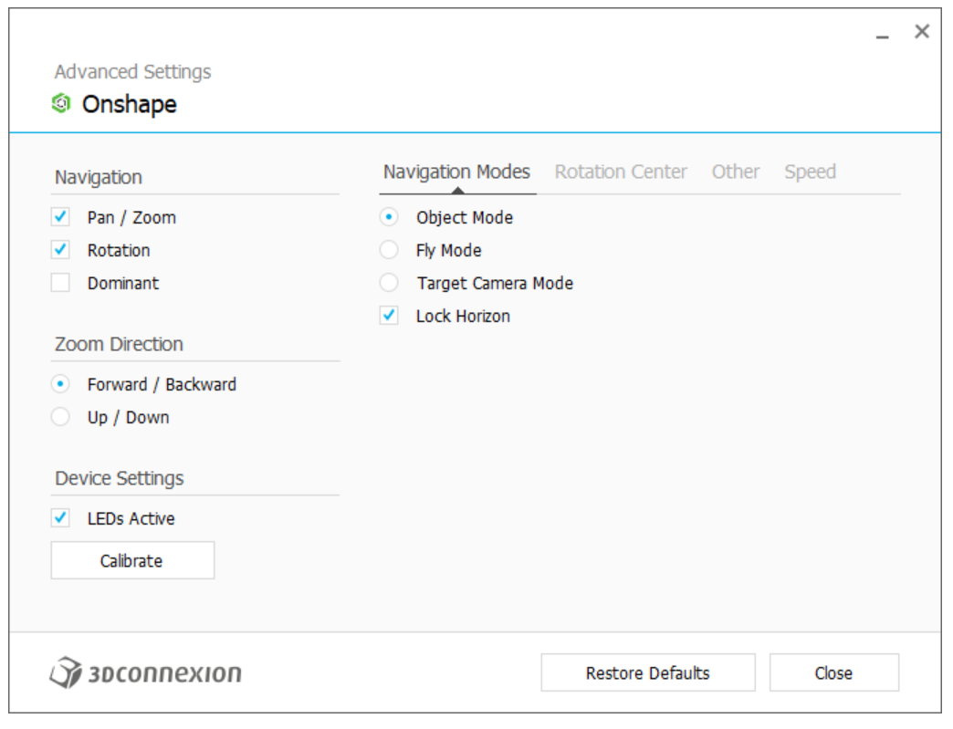

How are you able to see a Horizon Lock in the 3Dconnexion App? I've attached images of my NX and Onshape versions of the settings here, and I'm looking for something like the Lock Horizon. Thank you!

ramsri95 wrote: ↑Fri Sep 22, 2023 4:04 pm Hi David,
you are looking to Lock Horizon in NX as you do in OnShape Correct?
Easiest way would be to disable an Axis
In NX the option it gives you is Speed. to the left of the Speed bar are boxes which contain check marks in them.
Unchecking a box should disable that Axis and give you the desired effect.
