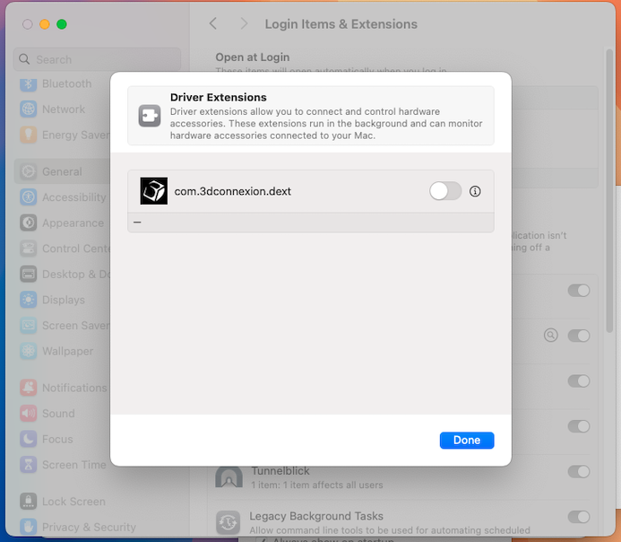

Thanks for pointing this out. Indeed, Open "Security & Privacy " button redirects to the setting tab where there is nothing about 3Dconnexion.
We will take care of this. For now, I advise you to use "Open System settings" button on the second window. You should be redirected and receicve this window:
Screenshot 2024-06-12 at 09.18.27.png (215.34 KiB) Viewed 21536 times
From here you have to toggle the switch and click done.

I have the exact same issue on MacOS Sequoia and when I click the "Open Security & Privacy" button on the popup screen, it opens it but there's still nothing about 3DConnexion there. I'm using a SpaceExplorer 3D Mouse. Is this hardware simply not supported?

Hi nilsynils
Sorry for inconvenience we are working on it.
For now you can simply go to Setttings -> General -> Login Items & Extensions. In this section scroll down and find information for 3Dconnexion and allow it.
