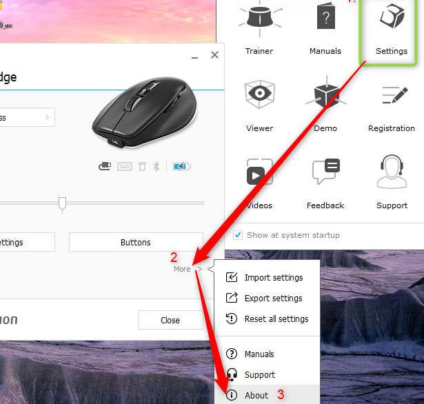

Hi supereriso
I would recommend delete the CADMOUSE COMPACT WIRELESS from your Bluetoooth settings (forget it etc.), connect the mouse via cable to PC and perform the update.
Can you check what firmware version you have currently on your mouse?
You can do it, by clicking Settings in 3DxHome application, clicking on "more" menu and selecting about.
In the bottom section you will find information about FW version of you mouse.
