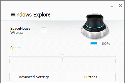

Downloaded the recommended/released 3DxWare 10.0.17 for SpaceMouse Wireless (my OS: Win7 64bit), installed it. The problem is, where do one configure 'Application Profiles' with .17 release ? If I start '3Dconnexion Properties' with .17, i get this little utility (3DxSmartUi.exe):
If I press 'Advanced Settings', it usually ends up with:
Only application that has worked with 'Advanced Settings' has been '3Dconnexion Viewer'. But options there do not look to have anything to do with 'Application Profiles'.

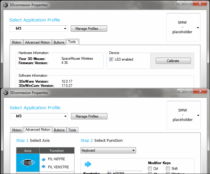

Now. Took a look at .16 beta release. Experimented with it on a clean Win7 64bit OS in a VMWare Workstation (USB passthrough for SpaceMouse Wirelesss). What I see there is that with .16 beta the '3Dconnexion Properties' goes to this utility (3DxConfig.exe):
A lot more like the stuff I was expecting. But why does '3Dconnexion Properties' go to different utilities in .17 (3DxSmartUi.exe) and .16 beta (3DxConfig.exe) ? 3DxConfig.exe does not exist in .17 install at all.
I did try to copy 3DxConfig.exe (& 3DxConfig.exe.config) from .16 beta install and use it on my physical machine installation. Is what the screenshot above is from. But when I try to assign/adjust any of the 'Advanced Motion' options on a profile. I get the 'Unhandled exception' dialog box, like screenshot further up.
Sooo. Am I looking in the wrong direction ? Is there another way with standard .17 installation to manipulate 'Application Profiles' ? Should I install .16 beta instead ? Point me in the right direction if I have missed something. Love to learn new stuff 8)

the 3DxWare 10.0.17 is the release driver for the SpaceMouse Wireless. There is no possibility to change the mapping on the axis. We had this possibility for a while in a beta phase. Which is 3DxWare 10.0.16. But the development of this driver is stopped. We currently do not have plans to follow up on this.
The unhandled exception error you see is probably caused by the non-English system you are using. This will be fixed in the next driver relase. Which is to be expected soon. :-)

you will have to stick with the beta version: 3DxWare 10.0.16. For further questions about the beta driver please use the 3DxWare 10 Beta forum.
