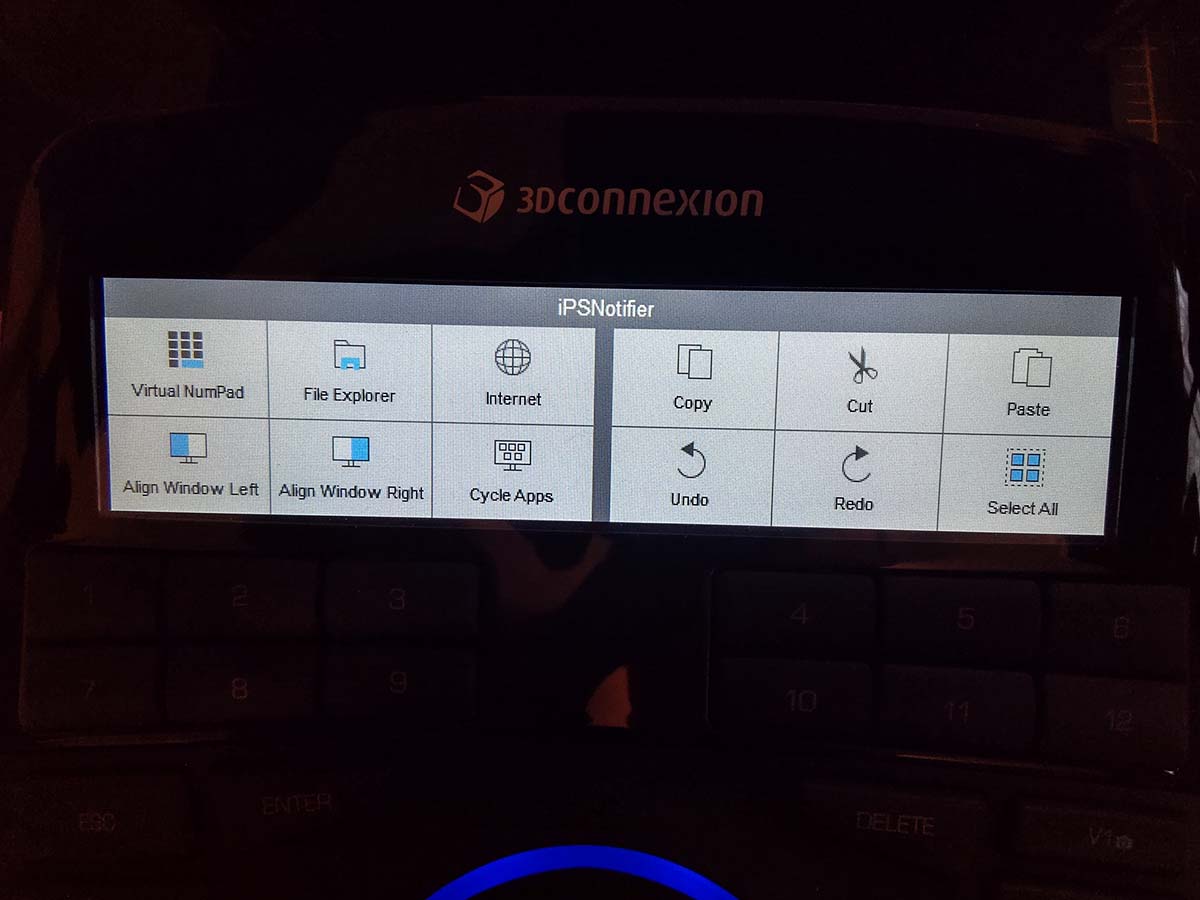

Confirmed. After long pressing a function key, if I'm in a program such as outlook, 3dsmax, Revit, etc. The screen will update and change accordingly, but once I click on my desktop and jump back into a program I get a default screen that has the header "iPSNotifer". This then stays the same screen until I long press one of the function keys while in a running program. Then switching between programs is normal.

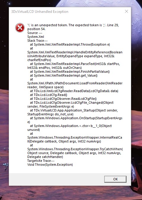

I've also been getting this error when long pressing a function key, when nothing is open and I'm just on the desktop.
Screenshot 2022-01-26 175845.jpg (105.76 KiB) Viewed 6743 times

Ah yes, iPSNotifier. This is an issue with a printer app from Brother that you have installed.
We have fixed it in the next release (in testing).
In the meantime, long pressing a button is indeed the fastest way to bring it back to life.
