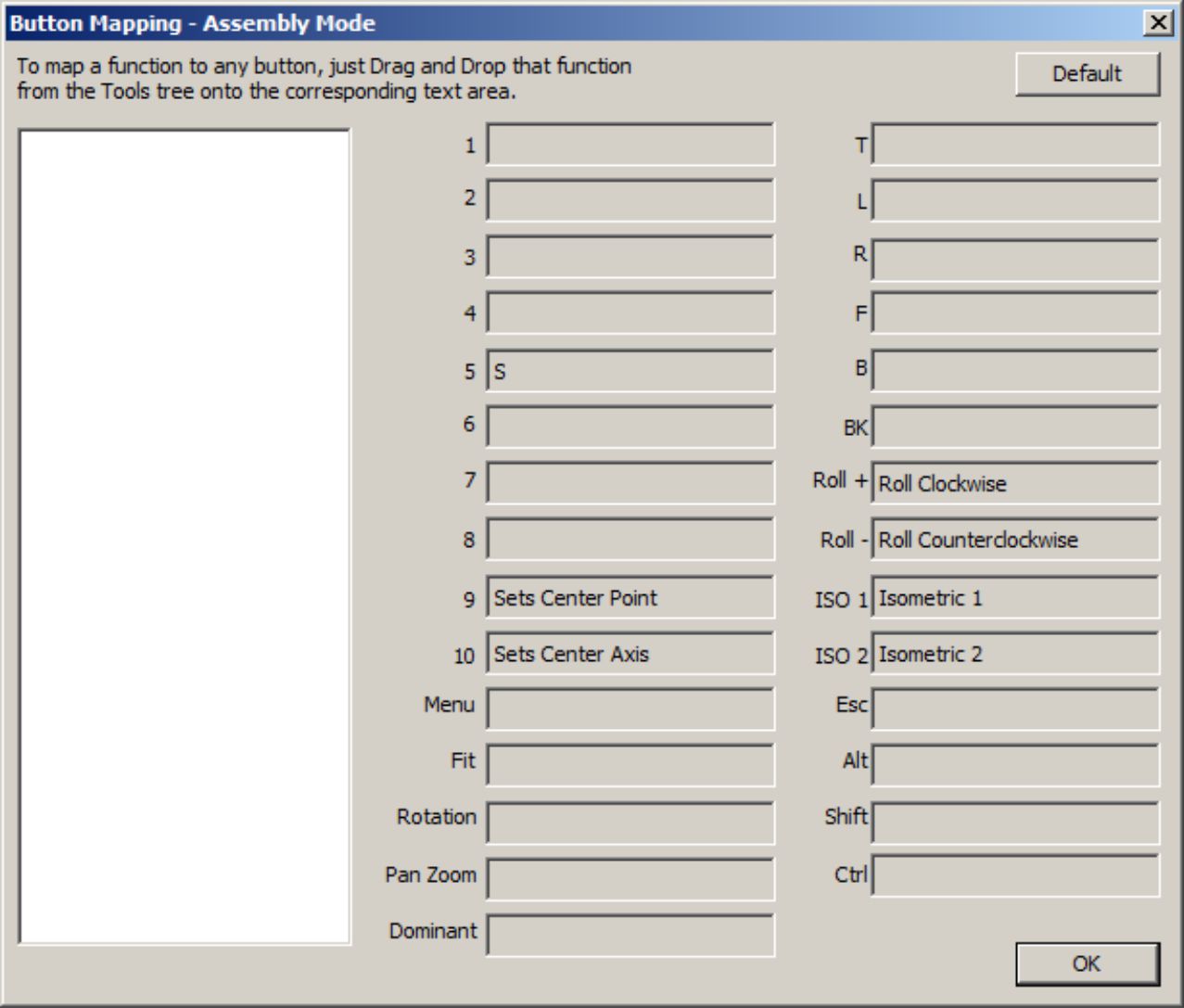

I just received a spacepilot pro at my new job. I installed the software and updated it. I run solidworks 2015 and have the latest service pack. When I click on the button mapping button in the toolbar in solidworks it brings up the button mapping box, but the tools tree is empty.
Button mapping panel.jpg (118.94 KiB) Viewed 15569 times
Any suggestions?
