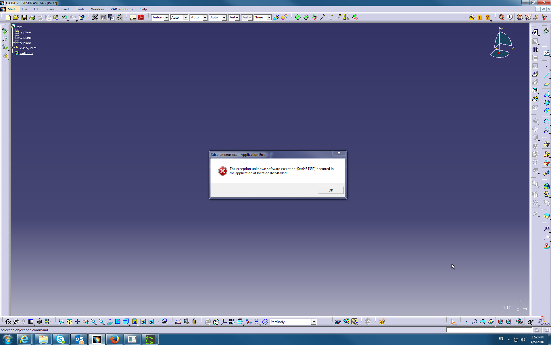

The dialogue appears " the exception unknown software exception (0xe0434352) occurred in the application at location 0xfcc4a06d"

Hi Wu Guan,
can you please post the screenshot of the error that you get?
I assume that you get the error only if you are using a button where a Radial Menu is mapped to?

Hello,
For your information.
Thank you very much for your done.
BR
Wu Guan

Hello Wu Guan,
does this happen with Catia only or do you see the same happen if you launch a Radial Menu in another application, for example in Excel or Outlook or the 3Dconnexion Viewer?

Hello,
Unfortunately it happened in any application, for example in CATIA, CREO, and so on.

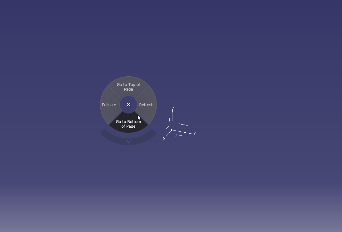

It was strange that button returned to work in this morning when I started computer.
Computer updated automatically on the weekends probably.
thank you all the same for your work.
Best Regards
Wu Guan
